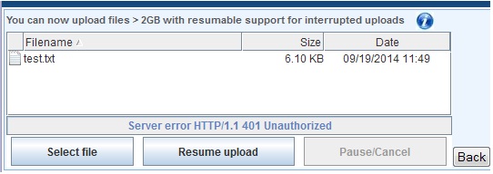

Re: HTTP/1.1 401 UnauthorizedPlease see the detailed scenario
I am using Jfile upload in my application which is in asp.net and it is hosted in IIS 7.5 web server with identity pool set to a local user account and when i upload file using jfileupload it gives me HTTP 1.1/ 401 Unauthorized Error in the file server where the applet suppose to upload the file the shared directory have the security access for the user which is domain user (Dir\UserName) with same username and password as that of webserver user (The user which is set in app pool identity of the website) Note that username and password in web server and file server are same and only difference is that one user is local user to the webserver and the one in file server is domain user but same password web server user --> "UserName" File server user --> "Dir\UserName" Please see the attachment for the error. Please help me in solving this issue.
Re: HTTP/1.1 401 UnauthorizedIt looks web server is expecting some credentials or authorization token for PUT verb.
Did you have a look to: http://www.jfileupload.com/products/jfi ... ation.html Try: <PARAM NAME="param9" VALUE="cookiesource"> <PARAM NAME="value9" VALUE="jse"> |
